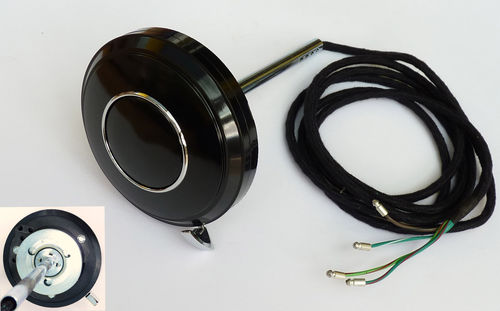

The "adjustable" control head has a much longer stub sticking out behind, to make the slot longer than the range of travel. The stator tube is correspondingly shorter, with a longer slot.
Here's a shot that shows the stub of a non-adjustable control head:
And here's a photo from eBay, showing the long stub:
PS, here's the shot from Mark Macy's web site, showing the difference in the slots
