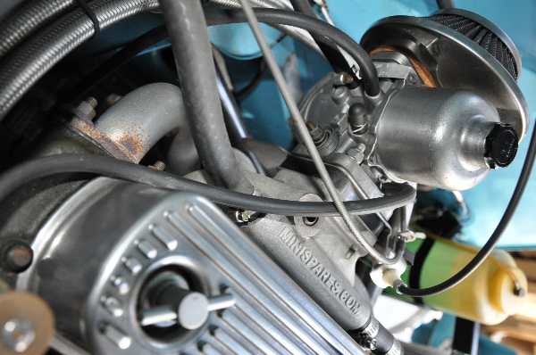

No guarantee and I didn't find it listed on the website but
my Minispares intake works fine and doesn't ding the BE hood.
Perhaps give these guys a ring or e-mail. They sure as heck made my intake for the HIF6. Their website address is cast into
the intake.
Motor runs great and it doesn't ding my hood.
Previous owner installed this set up around 2005. I don't know if it required modification but I do know it works.

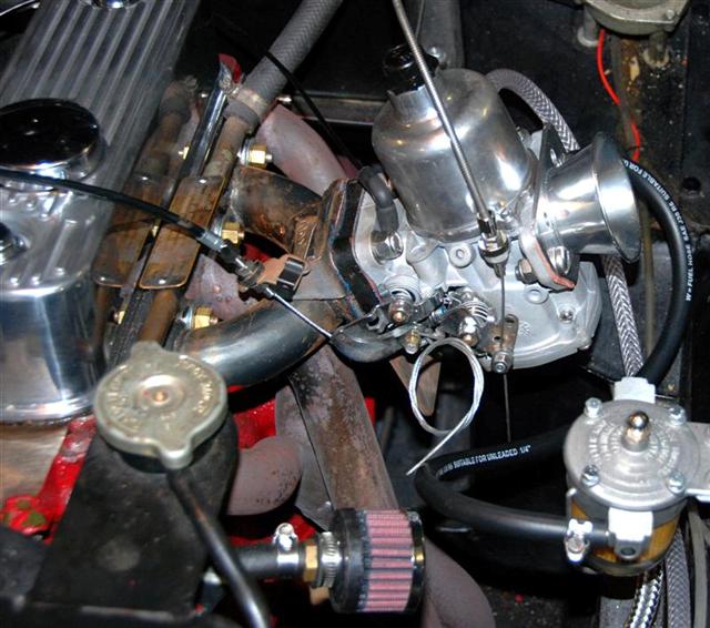

here is a link, yes it has pictures.
https://www.eatworms.org.uk/album/album2.php?album=Midget-HIF44&mode=page&index=1
