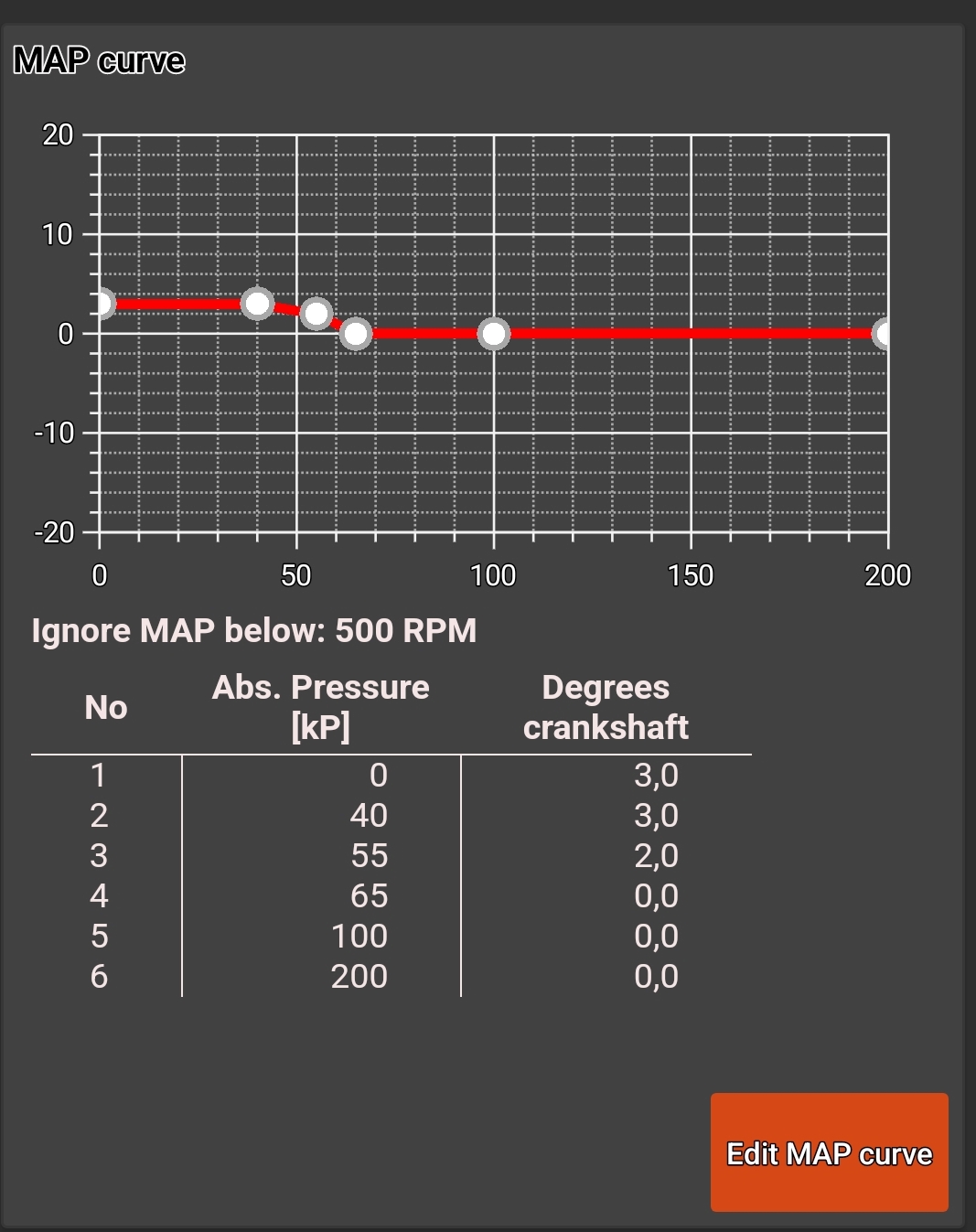

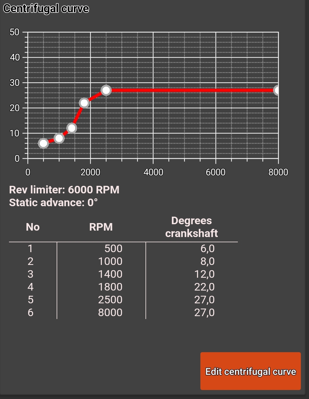

Hier ist meine ZĂĽndkurve mit Unterdruckkurve

OK, Now that I've had some running time I can't overstate how GREAT the 123Ignition is! My car has never run smoother, start quicker, and perform better. It feels that is has more HP. I HIGHLY RECOMMEND it to anyone that is thinking of it. The curves provided from hueyhoolihan worked perfect for my TR3. I couldn't be happier.
