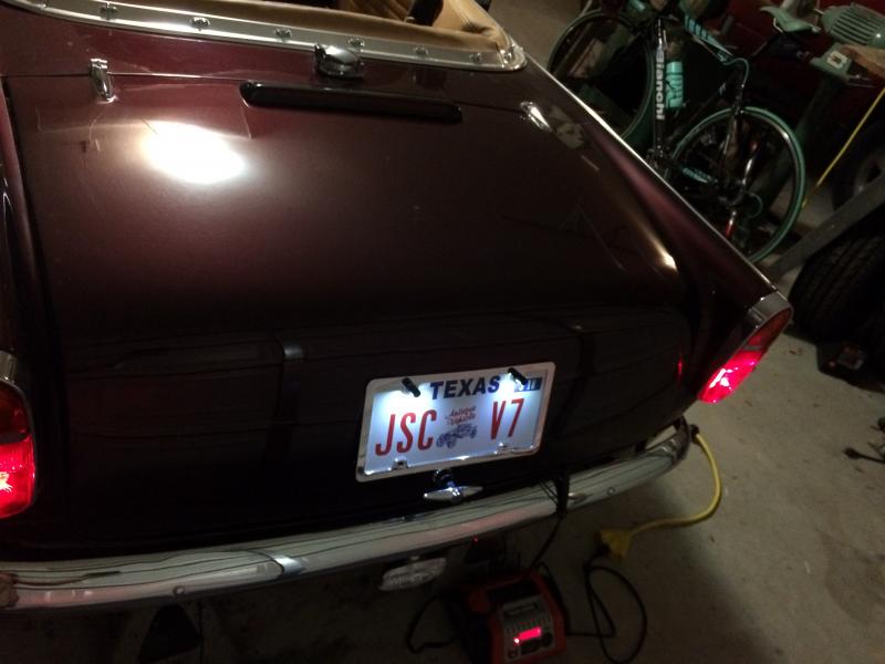

Hi Will. Considered them, but no, I didn't install them in the gauges so I can comment on the esthetics. But on a side note, I have done the entire exterior (except for the flashers) and noticed a helpful improvement. The rear red parking lights in particular are more visible as are the brake lights. Replacing just those eight bulbs yielded a noticeable improvement from the alternator.

You could have fooled me....I put 1157 base tail/brake light LED's in my TR6 several years ago and aside from the recent installation of LED head lights, they ae the only LED's in my external lighting.
