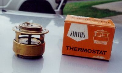

This thermostat was a bellows design (see 1st photo below) which had a
movable sleeve around its bellows which moved up as the thermostat's main valve
opened in response to rising engine heat.

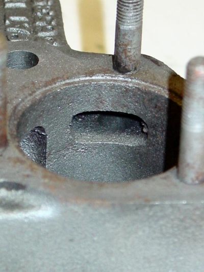

This movable sleeve, when the engine was cold, sat at a position that
allowed a coolant by-pass passage in the head (see 2nd photo below) to remain open, allowing warming coolant to
recirculate back into the head and engine while the main thermostat valve
blocked coolant from going into the radiator.

These bellows type thermostats from Smith's ceased
production before the end of production of the MGA and the more typical wax pellet
type thermostat we have been familiar with for the last 40 years, was
substituted. They were replaced as modern engineering increased the cooling system's pressurization. The higher system pressure played havoc with the functioning of the bellows type design as it relied on expanding gases to make it work, and pressurization counteracted that to the system's detriment.

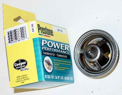

to allowing better, and better controlled, cooling. I had been made aware of what was called the "balanced"
thermostat designed by Robertshaw Controls (now marketed by Prestone ~ see
4th and 5th photos below) by my hot rod buddies and so I got one and used it instead of the common
pellet type. Although I will not say
that its effectiveness is entirely obvious when you drop one in, it does become
a bit more plain when driving at sustained highway speeds (70+ mph) as the temp
does seem a bit more stable and when under the strain of mountain climbing, it
takes longer for the inevitable rise to occur.
The balanced design is such that it is not influenced by coolant pressure
increases or decreases as engine rpms rise and fall, and that means that it is
better able to more accurately control temperature than pellet type T-stats.

This is a photo of the OE type Smith's Bellows Thermostat. Note the moving sleeve along the outside of the bellows. This ring was intended to cut off the bypass port in the head once the engine warmed to normal. Photo: Neal Cotty
A photo of the bypass port in the head. As you can see, it lies just below the nesting place for the thermostat, and you can see that when the OE Smith's T-stat's sleeve rose up, it would shut off this passage. Note also the drilled passage inside leading down into the head and block.

Just a photo showing two views of the Robertshaw designed Balanced type T-stat (upper) and a side view of the commonly used wax pellet type T-stat (below). Both will work with the blanking sleeve, I just happen to like the action of the Balanced type.
Robertshaw no longer markets the balanced T-stat, but it has been picked up for marketing by Prestone. In this case, the Model # is 330-195, indicating that it opens at 195F. A 160F T-stat would carry the # 330-160 part number, and a 185F unit, #330-185. If you have difficulty finding these, simply copy this photo to your computer and print off a copy and take it to your parts house. They will then know that they DO exist, and with the UPC code, they will know more about how to find you one.

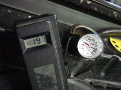

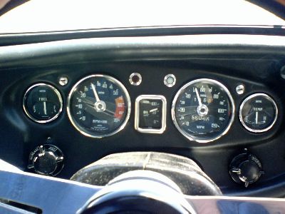

This photo shows coolant temp taken while the engine was running after a short run. The electric fan was running, and coolant flowing into the top tank of the radiator. The two temp gauges, one a typical mechanical pocket gauge and the larger black box, a precision calibrated electronic gauge had their probes extended into the coolant through the radiator filler neck and as close to the radiator inlet as possible. As you can see, they give reasonably comparable readings of about 197F.

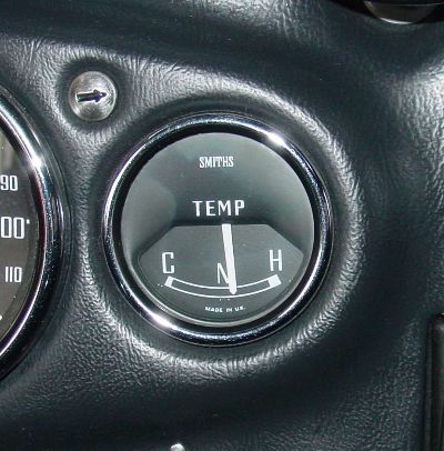

A photo taken within 10 secs of the photo above of the dash gauge.
I post this as a relative indication of what the "Normal" range probably is in most MGBs. Anyone can duplicate this process to resolve for themselves how well "calibrated" their particular MGB's temp gauge might be. At least you would then know what "Normal" means in actual degrees for your car.

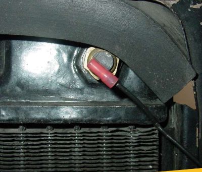

Many folks will want to add an electric fan(s) to their MGB cooling system. One thing necessary will be the installation of some sort of triggering switch that brings the fan on line at the right temperature.
In my case, I used an existing switch originally intended for a Toyota, Wells TU-68. This is a threaded body switch, which requires that a hole be cut into the top tank and threaded "bung" be soldered/brazed into the hole to receive the switch. The photo below simply shows how I positioned the switch on my 68 GT (on the rear of the tank on the RH side), but exact positioning is not critical with most MGBs as there is a baffle in the top tank to help spread the incoming coolant from the engine more or less evenly into the top of the core, rather than letting it concentrate towards the inlet side of the radiator.
There are other choices, to be sure, but I chose this setup simply because it would provide what I felt was the best sealing and easy replacement if the switch someday goes bad.

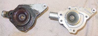

If you look carefully at this photo you will note that the AP made pump on the left has a somewhat larger diameter impeller than the Burgess made pump next to it. Both pumps are for the same application, but the AP pump will fit the hole in the block more completely and has more swept area to move coolant. They ar both well made pumps and both have worked well for me, but I thought you might want to note the differences from one to another. It could make a difference, if only to you.

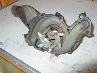

On occasion, cheap MGB water pumps will come with sheet metal impellers. I don't like them because I believe that they can lead to cavitation more easily.
However, I show you this photo of a water pump out of my son's old Cadillac. This is what we found when we took it off. Not a very pretty sight. FWIW
